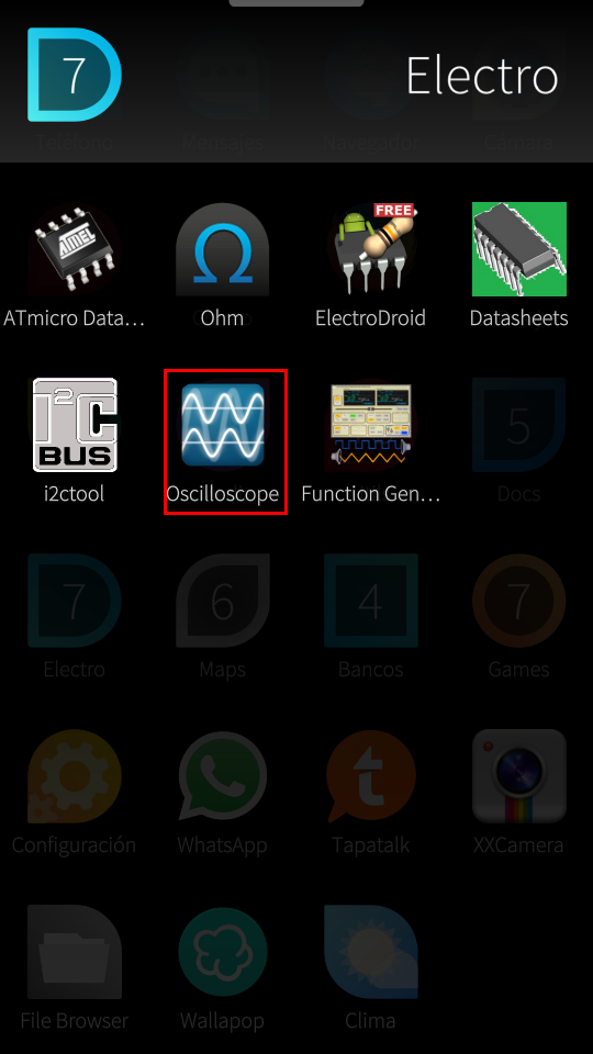

Apps menu - Osciloscope

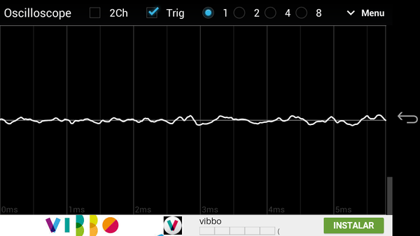

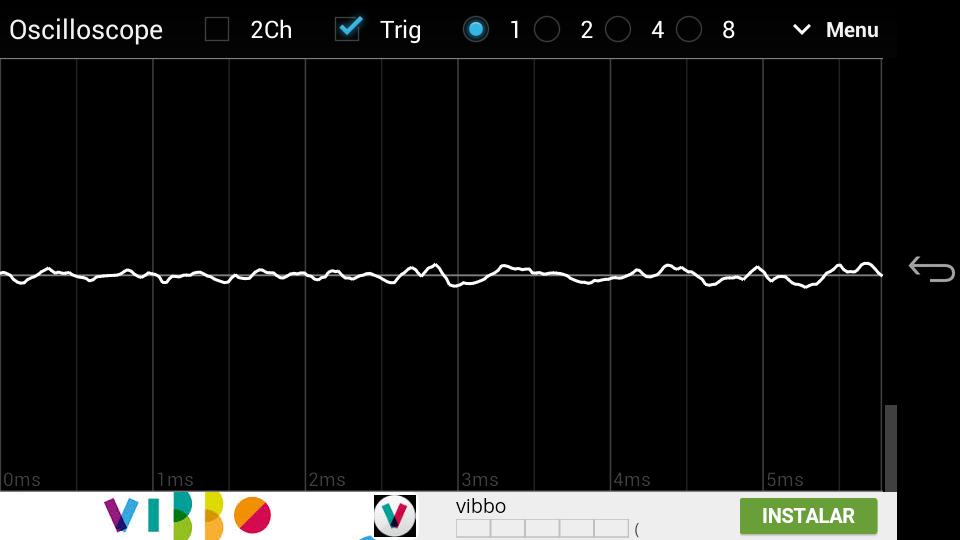

Osciloscope - 1 channel

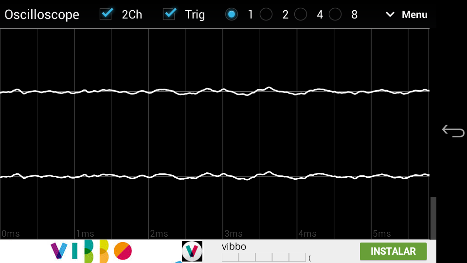

Osciloscope - 2 channels
